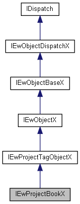

Inheritance diagram for IEwProjectBookX:
Additional Inherited Members
