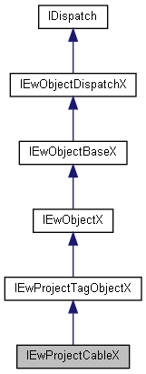

IEwProjectCableX Interface Reference
Use this interface to manage a cable inside a project. More...
Inheritance diagram for IEwProjectCableX:

- Public Member Functions inherited from IEwObjectX
LONG getID ()
- Public Member Functions inherited from IEwObjectBaseX
EwErrorCode insert ()
 Insert the object inside the current project. More...
EwErrorCode remove ()
 Remove the object from the current project. More...
EwErrorCode update ()
 Update the object inside the current project. More...
