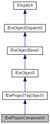

IEwProjectComponentX Interface Reference
Use this interface to manage a component inside a project. More...
Inheritance diagram for IEwProjectComponentX:
