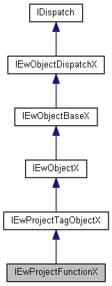

IEwProjectFunctionX Interface Reference
Use this interface to manage function inside a project. More...
Inheritance diagram for IEwProjectFunctionX:

- Public Member Functions inherited from IEwProjectTagObjectX
EwErrorCode setUserData (LONG nUserDataNumber, BSTR strValue)
 Set user data of the object. More...
BSTR getUserData (LONG nUserDataNumber, EwErrorCode *errorCode)
 Get user data of the object. More...
EwErrorCode setTranslatedData (LONG nUserDataNumber, BSTR strLanguage, BSTR strValue)
 Set the value of a translated text. More...
BSTR getTranslatedData (LONG nUserDataNumber, BSTR strLanguage, EwErrorCode *errorCode)
 Get the value of a translated text. More...
BSTR getTag (EwErrorCode *errorCode)
 Get the mark of this object. More...
EwErrorCode setTag (BSTR strValue)
 Set the mark of this object. More...
BSTR getTagRoot (EwErrorCode *errorCode)
 Get the mark root of this object. More...
EwErrorCode setTagRoot (BSTR strValue)
 Set the mark root of this object. More...
EwTagMode getTagMode (EwErrorCode *errorCode)
 Get the mark mode of this object. More...
EwErrorCode setTagMode (EwTagMode eTagMode)
 Set the mark mode of this object. More...
long getTagNumber (EwErrorCode *errorCode)
 Get the mark number of this object. More...
EwErrorCode setTagNumber (long lValue)
 Set the mark number of this object. More...
EwErrorCode setNextTagNumber ()
 Set the next number to have a unique mark. More...
VARIANT_BOOL isTagUnique (EwErrorCode *errorCode)
 Returns true or false if mark is unique. More...
- Public Member Functions inherited from IEwObjectX
LONG getID ()
- Public Member Functions inherited from IEwObjectBaseX
EwErrorCode insert ()
 Insert the object inside the current project. More...
EwErrorCode remove ()
 Remove the object from the current project. More...
EwErrorCode update ()
 Update the object inside the current project. More...
