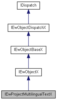

IEwProjectMultilingualTextX Interface Reference
Use this interface to manage a Multilingual Text inside a project. More...
Inheritance diagram for IEwProjectMultilingualTextX:
