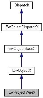

Inheritance diagram for IEwProjectWireX:
