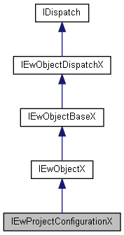

Inheritance diagram for IEwProjectConfigurationX:
