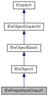

Use this interface to manage input/output object inside a project. More...
Return the Channel Address.
Return the Function ID of the Input/Output object.
-1 By default.
Return the Key for the cross reference.
"PIA" by default.
Return the name of the macro associated.
Return the Mnemonic.
Return the IEwProjectComponentCircuitX ID associated with the Input/Output object.
Get the value of a translated text.
Get user data of the object.
Set the Function ID for the Input/Output object.
Sets the Key for the cross reference.
Could be:
Sets the name of the macro associated.
Sets the Mnemonic.
Sets the IEwProjectComponentCircuitX ID associated with the Input/Output object.
Set the value of a translated text.
Set user data of the object.
