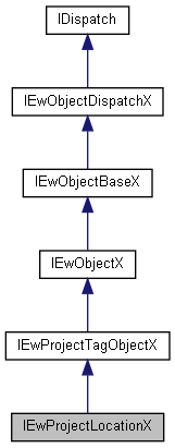

IEwProjectLocationX Interface Reference
Use this interface to manage the location inside a project. More...
Inheritance diagram for IEwProjectLocationX:

- Public Member Functions inherited from IEwProjectTagObjectX

- Public Member Functions inherited from IEwObjectX
LONG getID ()
- Public Member Functions inherited from IEwObjectBaseX
