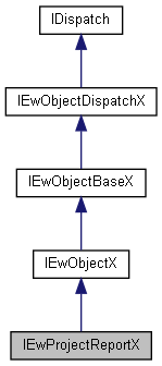

IEwProjectReportX Interface Reference
Use this interface to manage the report used inside the project. More...
Inheritance diagram for IEwProjectReportX:
