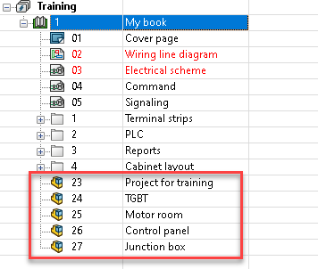

Automatic SOLIDWORKS File Generation
The files that allow you to insert materials are automatically generated by SOLIDWORKS Electrical.
To generate the new files, in the SOLIDWORKS Electrical toolbar, do one of the following:
  • In the menu, click Tools > SOLIDWORKS Electrical > Process > SOLIDWORKS Assembly .
  • Right-click a project and select Process > SOLIDWORKS Assembly .
To use an existing assembly, click Select existing file and select the required file in your workstation. This file is the shortcut file.
The files are automatically added to the electrical project pages.
Double-click a file to open it in the graphics area (or right-click the file and click Open).
