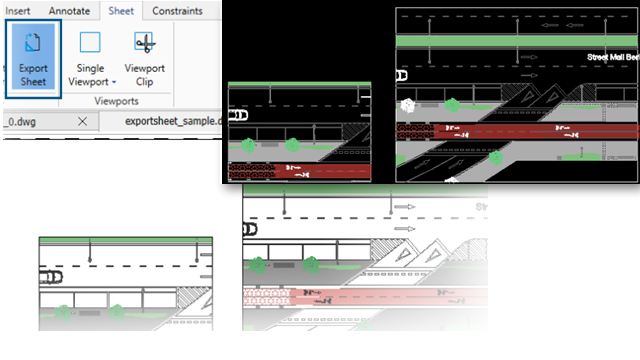

You can export all
visible entities from an active sheet viewport and entities from the sheets to the new
drawing.
This lets you edit
the representation created in the new drawing using commands like TRIM, COPY/PASTE,
EXPLODE, STRETCH.
To access the Export Sheet
command:
Do one of the following:
- On the ribbon, click .
- On the menu, click .
- Enter EXPORTSHEET in the
command window.
