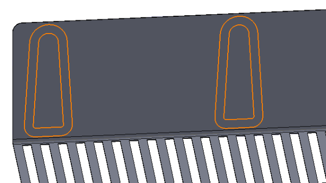

![](axr1683746291462.image)
In the
DXF
/ DWG Output PropertyManager, when you export a sheet metal flat pattern
as a
.dxf
file, you can exclude hidden sketches.
To
exclude hidden sketches from flat pattern DXF files:
- In the PropertyManager:
- Under Export, select Sheet metal.
- Under Entities to Export, select
Sketches and under Sketches, select Exclude hidden sketches.
