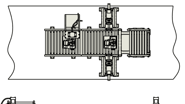

Opening a Drawing in Detailing Mode by Default
You can open a drawing in Detailing mode by default.
You can use this to automatically open large drawings quickly.
