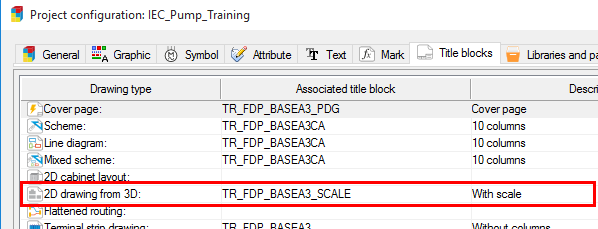

drawing file opens in the graphics area. The software uses the dimensions of
the title block settings in the
Electrical
project
configuration.

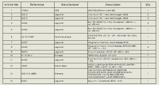

SOLIDWORKS manages the BOM. It is a bill of
parts and not an equipment report, such as you might have in SOLIDWORKS
Electrical Schematic. You use this SOLIDWORKS BOM mainly to meet mechanical
drawing requirements.
- In the PropertyManager:
- Select the drawing view.
- Under Table
Template, select bom-standard.
- Under BOM Type,
click Top-level only.
- Click
- Drag the BOM and click to position it below the drawing view.
- Use the hover over
tools
to modify the BOM:
- Delete the Material column.
- Use the
column
property edit
tools
for the Part number column to
display the manufacturer part.
- Add the Manufacturer column.

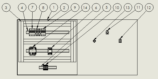

- On the Annotation tab of
the CommandManager, click Auto Balloon
and click the drawing view to
automatically place the balloons.
- Under Balloon
Layout, click Layout
Balloons to Top
and clear Ignore multiple instances.
- Click
Verify that the balloon numbers match the
items
in the BOM.

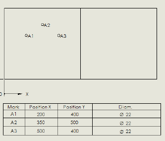

- Click
- Under Datum, for
Origin, in the drawing view,
select the lower-left vertex of the cabinet.
- Under Holes, for
Edges/Faces, in the drawing
view, select the three holes.
- Click
- Drag to position the hole table on the drawing sheet and
click to place it.

You
generate a project drawing from a 2D drawing. This process automatically adds a
title block and saves the file in .EWG format
in the Drawings directory of the electrical
project.
