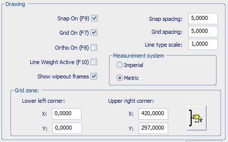

- Specify the snap spacing so that the connection points have the same
intervals as the distance between the wires (5mm by default).
- Right-click the lock bar to open the Drawing support dialog
box.
- Specify the snap and grid settings:
- Delete the rectangle.
- Create poles 2 and 3 of the circuit breaker by copying the first pole.
With the snap spacing locked, the poles are equidistant at
5mm.
