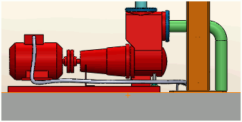

- On the SOLIDWORKS Electrical
3D tab of the CommandManager, click Route Cables
. When
you
run
routing for the first time, use 3DSketch
Route mode to visually check that the cables are routed
correctly. Modify the routing parameters according to the routing paths. If
the cables are not routed correctly, check the Routing Analysis dialog box to debug the layout.
- In the PropertyManager, for Select
route type, click 3DSketch
Route, then click
.The
Routing Analysis: Cable routing
dialog box reports several errors.
- Examine the model to determine the reasons for the analysis
errors.
