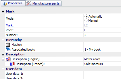

- In the Location
properties dialog box, for
Description (English), type
Motor
room
and
click OK.
- Repeat steps 2 and 3 for the L3
location, type
Control panel for Description (English).
- Repeat
steps 2 and 3
for the
L4
location.
Change the mark and add the description by doing the following:
- On the Properties tab, under
, click
Manual.
- For
Mark, type
BJ.
- For
Description
(English), type
Junction box.
- In the Location
management dialog box, click Close.
