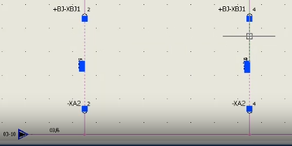

- Zoom in to the bottom-left corner, right-click the end of the
wire, and click Edit wire marks.
- In the dialog box, under Equipotentials marks, for New, type
03/6.
- When prompted about duplicated marks, click Yes, then click OK.
- Click .
A dialog box displays the
arrows used for the origin and destination.
- Select Connect all equipotential
with the same mark (not shown in the video), and click
OK.
This
automatically connects the wires that have the same number.
- View the selected origin and destination arrows in documents
03 - Scheme and 05 - Signaling for the two selected wires.

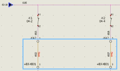

- In the document 05 -
Signaling, right-click the leftmost vertical wire as shown in the
video and click Associate cable cores.
- In the dialog box:
- In the top panel for Cables, under Description, expand and select item 1.
- In the bottom panel for Wires to associate with cable cores, select Wire 05/2.
- In the menu, click Associate cable cores
and click OK.
- Right-click the rightmost vertical wire as shown in the video
- In the top panel for Cables, under Description, expand and select item 2.
- In the bottom panel for Wires to associate with cable cores, select Wire 05/7.
and click OK.
The associated wires change color in the graphics
area.
- Box select the two wires as shown in the video,
right-click
- In the top panel for Cables, under Description, expand and select items 3 and 4.
- In the bottom panel for Wires to associate with cable cores, select Wire 05/5 and Wire 05/10.
and click OK.
