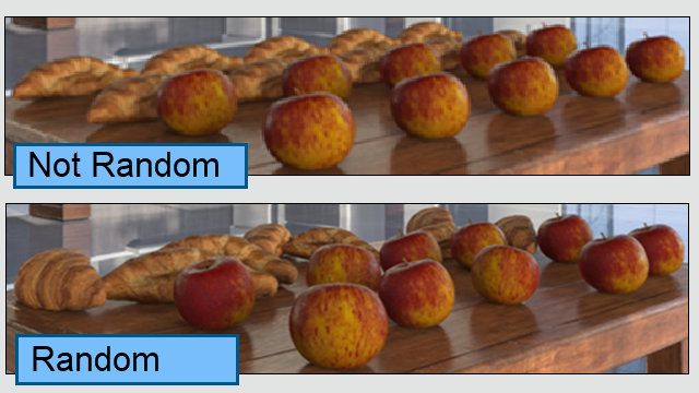

You can easily apply a random amount of position, rotation, and scale values to a group of patterned instances and other selected objects.
Benefits: This feature helps create more realistic renders when dealing with collections of the same object by randomly adjusting their position, rotation, or scale.
