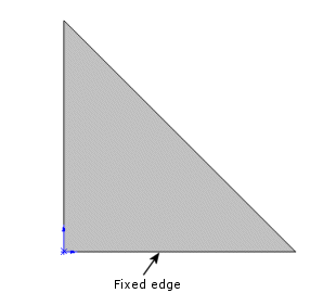

Calculate the natural frequencies of a right-angle isosceles triangle wing. The equal sides of the triangle are 6" in long and the thickness is 0.034". One of the equal sides of the triangle is fixed.

Shell Parameters
Shell thickness = 0.034 in - Thin formulation.
Material Properties
Modulus of elasticity = 6.5 x 106 psi, Poisson's ratio = 0.3541, Density = 0.06411 lb/in3.
