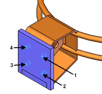

The basketball rim and the backboard are attached together by four identical bolts.
The following table shows the parameters of the four bolt connectors:

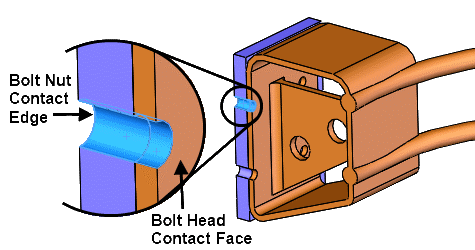

The following image shows the edges that define a bolt connector between two components. The bolt head contact edge belongs to Component 1 (Basketball_rim) and the bolt nut contact edge belongs to Component 2 (Backboard).
The four bolts are shown below.
