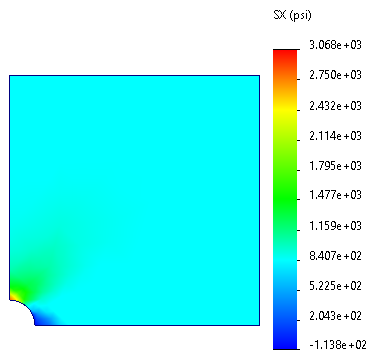

Viewing Results of the h-Adaptive Method
  1. To view how the h-adaptive method converted the mesh, under Mesh , right-click Quality1 (-Mesh-) and click Show.
  2. Create a plot of normal stress in the global X-direction. In the Stress plot PropertyManager, select SX: X Normal Stress for Component and psi for Units .
