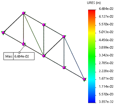

Viewing Displacement In the Simulation study tree, right-click the Results folder and select Define Displacement Plot . In the PropertyManager, under Display: Select URES: Resultant Displacement in Component . Select in for Units . Under Deformed shape, select True Scale. Click . The maximum displacement of 0.066 inches occurs on the joint where the load is applied. Parent topicStatic Analysis of a Truss Previous topic Meshing the Model and Running the Study Next topic Viewing Reaction Forces
