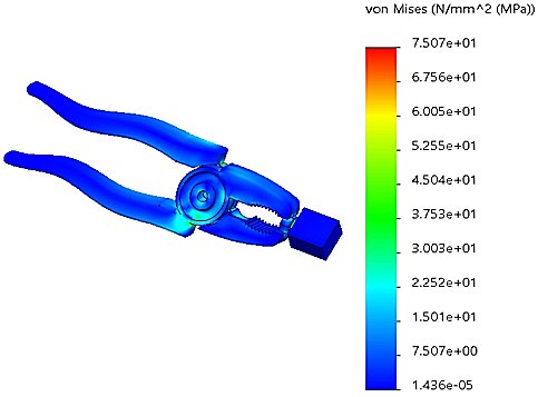

Viewing Results To view the von Mises stress plot: In the Simulation study tree, open the Results folder. Double-click Stress1 (-vonMises-) to display the plot. If the plot does not exist, create this plot. The von Mises stress values are shown in MPa. Congratulations! You have completed this lesson. Parent topicPliers Defined Using Pins Previous topic Listing Pin Forces
