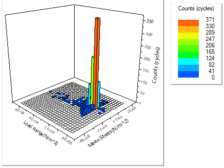

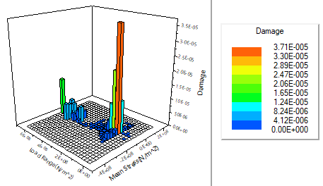

Viewing Fatigue Results Right-click the Results folder and click Define Matrix Chart. In the Matrix Charts PropertyManager, do the following: Under Location, select Worst damage location. Under Type, select Rainflow matrix. Click . The following plot is displayed for the node with the worst damage location. Right-click the Results folder and click Define Matrix Chart. In the Matrix Charts PropertyManager, do the following: Under Location, select Worst damage location. Under Type, select Damage matrix. Click . The following plot is displayed for the node with the worst damage location. Congratulations! You have completed this lesson. Parent topicFatigue Analysis of a Landing Gear Previous topic Running the Fatigue Analysis and Viewing Results
