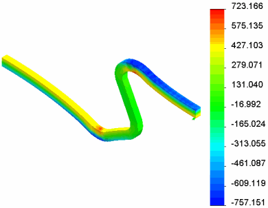

Viewing Stress Results In the Simulation study tree, right-click the Results folder, and select Define Stress Plot. In the PropertyManager: Under Display, set Component to SX: X Normal Stress. Set Units to N/mm^2 (MPa). Under Plot Step, set Time to 1 second. A Time of 1 second corresponds to the full application of the prescribed displacement (7 mm). In the Deformed shape box, make sure True scale is selected. Click . Stress2 (-X normal-) appears in the Results folder and appears in the graphics area. Parent topicSimulation of Orthodontic Archwire with Nitinol Material Model Previous topic Meshing the Model and Running the Study Next topic Comparing the Deformed and Undeformed Shapes
