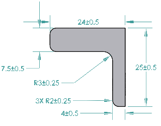

  2. Inspect the dimensions by annotation view:
Front view
The instance count (3x) is part of the R2 radius dimension.

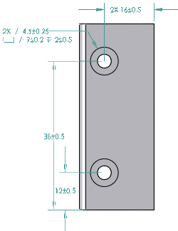

Right view
The instance count and chain dimensions are part of the 3X counterbore hole pattern.

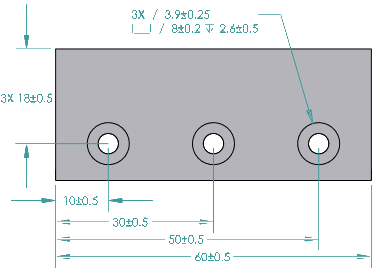

Top view
The instance count and chain dimensions are part of the 2X counterbore hole pattern.
