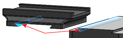

Adding Another Mate Between the Saddle and Knee Click Mate (Assembly tab). Click Keep Visible if it is not selected. Select the corresponding angular faces on the saddle and knee as shown. The Mate pop-up toolbar appears in the graphics area. Coincident is selected in the PropertyManager and the pop-up toolbar. A preview of the coincident mate appears. Click Add/Finish Mate (Mate pop-up toolbar). The selected angular faces are now mated. Parent topicAssembly Mates Previous topic Testing the Saddle and Knee Mate Next topic Mating the Table and Saddle
