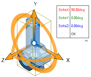

Rotate the pin so it is vertical.
  1. Right-click the pin and click Move with Triad .
  2. Right-click the center sphere of the triad and click Show Rotate Delta XYZ Box.
  3. In the box:
    1. Enter 90 for DeltaX.
    2. Click OK three times, so the pin is vertical.
  4. Click anywhere in the graphics area to close the box.
