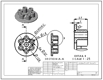

Modifying the Text of Dimensions Select the cylinder boss diameter (27) dimension. In the PropertyManager, under Dimension Text, click in front of <MOD-DIAM>. Type 6x. The dimension now indicates that there are six cylinders of the same size in the drawing. Repeat steps 1 through 3 for the cylinder boss hole diameter (15) dimension. Select the center hole diameter (25) dimension. In the PropertyManager, under Dimension Text, click after <DIM>. Type a space and THRU. The dimension now indicates a through all cut. Click . This completes the drawing. Click File > Save to This PC. Congratulations! You have completed this tutorial. Parent topicIntroduction to SOLIDWORKS Previous topic Placing Detail Dimensions
