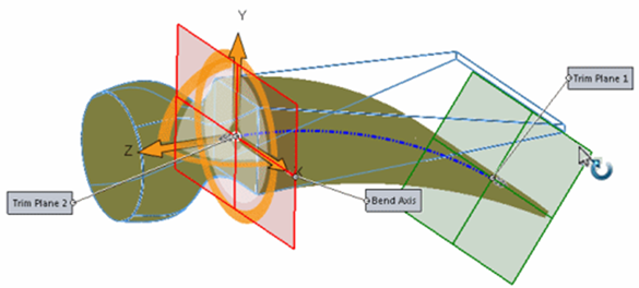

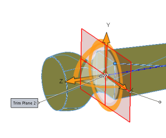

Completing the Bend Right-click the triad's center sphere and select Move Triad to Plane 2. The center of the model is aligned with the center of the triad. Drag the pointer over an edge of Trim Plane 1. When the pointer changes to , click and drag the pointer up and down. Only the material between the trim planes moves. Click . Congratulations! You have completed this tutorial. Parent topicLoft Features Previous topic Bending the Part with the Flex Feature
