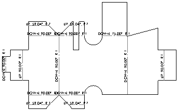

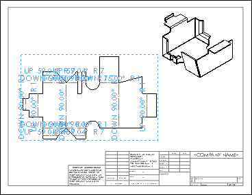

Adjusting the Bend Notes
First reduce the font size.
You can set font size as well as other options as part of the drawing template.
  1. Box-select the drawing.
  2. In the PropertyManager:
    1. Under Text Format, clear Use document font.
    2. Click Font.
  3. In the Choose Font dialog box, select Points, 9 for Height, and click OK.
  4. Click the sheet to clear the block-select.
