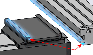

Mating the Angular Faces
  1. Select the corresponding angular faces on the table and saddle.
  2. Accept the Coincident mate.
  3. Close the PropertyManager.
  4. Click Isometric (Heads-up View toolbar).
  5. Drag the table.
    The table and saddle are still not fully constrained.
