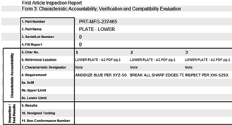

Vertical Based Template / Horizontal Based Template Displays tokens vertically or horizontally in report templates. Select the orientation before inserting tokens in a report.
For example, if you select Horizontal Based Template and set Characteristic Token to Balloon Number, each column displays a Balloon Number (1,2,3,...). If you select Vertical Based Template, Balloon Number displays in rows instead of columns.
Horizontal Based Template:
Vertical Based Template:
