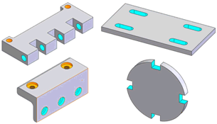

| Pattern
A group of DimXpert features having the same type (hole, slot, notch, etc.) and size parameters.
They are generally associated with common dimensions and tolerances. For example, applying a diameter dimension and geometric position tolerance to a pattern of holes.
- Chamfer
- Counterbore hole
- Countersink hole
- Cylinder
- Fillet
- Notch
- Simple Hole
- Slot
 Simple hole, counterbore, slot, and notch pattern features
