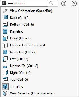

The Search Commands functionality provides better results because of enhanced terminology mapping. Terminology from other CAD packages is mapped to SOLIDWORKS tools to help you find the tools you need. The search results also include keyboard shortcuts for quicker access to the tools.

The software includes more keywords that map to SOLIDWORKS tools. This is helpful when you search for a tool that does not necessarily use the SOLIDWORKS names. For example, if you search for a term used in a different CAD product, the corresponding SOLIDWORKS tool may appear in the search results.
Keyboard Shortcuts
When you use Search Commands, the results include the tools' keyboard shortcuts in parenthesis if they exist. If you use the S key to search for tools, the results also list the keyboard shortcut.
