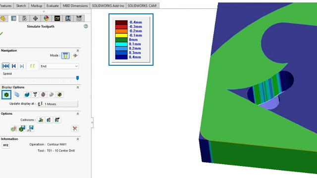

During
toolpath simulations, you can move the legend that shows the graphical comparison of the
machined part and the design part.
In the
Simulate Toolpath PropertyManager, under Display
Options, click Show Difference
. In the graphics area, you can move the
legend.
