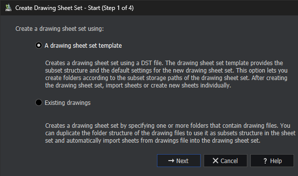

3DEXPERIENCE DraftSight lets you create the Sheet Set Data (DST) files and save them to bookmarks. You can open the saved DST files from bookmarks.
You can also define the properties of the Sheet Set Manager. See Working with Drawing Sheet Sets. You can create DST files using an existing drawing or drawing sheet set template. 3DEXPERIENCE DraftSight creates DST files as PLM objects.
