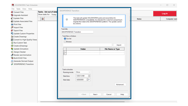

Creating a 3DEXPERIENCE Transition Task
To create a 3DEXPERIENCE Transition task:
  1. In SOLIDWORKS Task Scheduler, click 3DEXPERIENCE Transition.
  2. Under Task title, create a name for your task.
  3. Under Task files or folders, select the content you want to update by doing one of the following:
    • Browse for a file or folder to add to Task Files or Folders.
    • Import a .csv file that specifies the content to add to Task Files or Folders.
      The format of the .csv file is path,filename. For example to add clamp.sldprt and bracket.sldrpt, write:
      • "C:\Users\Public\Documents\SOLIDWORKS\SOLIDWORKS 2025\samples\tutorial\assemblymates","clamp.sldprt"
      • "C:\Users\Public\Documents\SOLIDWORKS\SOLIDWORKS 2025\samples\tutorial\assemblymates","bracket.sldprt"
  4. Run the task immediately or schedule the task.
  5. Click Next.
  6. In the Options dialog box, specify options:
