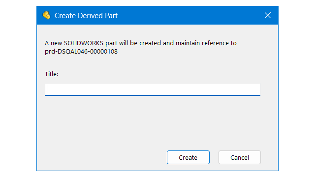

Creating Derived Parts in SOLIDWORKS Assemblies
After you insert a 3DEXPERIENCE component into a SOLIDWORKS assembly in the FeatureManager® design tree, you can right-click the component and select Create Derived Part.
2025 2026
The New Document Name dialog box appears. The Create Derived Part dialog box appears.
During the workflow, the Save to 3DEXPERIENCE dialog box appears. The Save to 3DEXPERIENCE dialog box no longer appears. You can save to the 3DEXPERIENCE platform whenever you want after you create the derived part.
