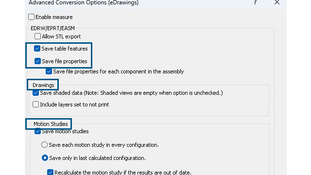

  • A modified user interface for the eDrawings file format similar to the SOLIDWORKS export System options for better clarity and usability. For example, the existing options are grouped under sections and the following options are added:
    • Save table features
    • Save file properties
  • Support of higher versions for Parasolid (up to 35.1) and ACIS (up to 33.0) file formats.
  • A new eDrawings Web HTML (*.html) option under Output file format. The user interface of the Advanced Conversion Options dialog box for this new option is similar to eDrawings options (All options are unmodifiable except Enable measure).
