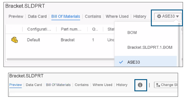

Named BOM and File Details in the Web2 Client
In the SOLIDWORKS PDM Web2 client, some tabs have been updated for you to have better visibility of the information.
You can:
  • View the Named BOM under BOM types in the Bill Of Materials tab for the file.
  • Click under either Preview or Data Card to display the file information.
