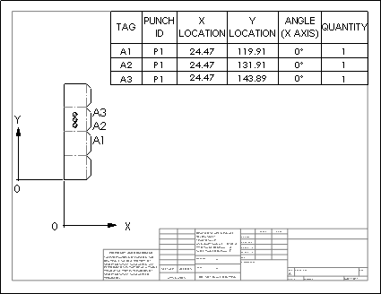

Inserting a Punch Table
Punch tables are available with the flat pattern view of sheet metal parts and contain the form features and library features used in sheet metal bodies.
- In cover.sldprt, click Make Drawing from Part/Assembly
(Standard toolbar) or .
- In the New SolidWorks Document dialog box, click Drawing
, then click OK.
- In the Sheet Format/Size dialog box, click OK.
- In the View Palette, drag the Flat pattern view onto the sheet.
- In the PropertyManager, click
- Click Punch Table
(Table toolbar) or .
- In the graphics area, click:
- The point as shown for Origin.
- Any face for Edges/Faces/Features.
- In the graphics area, click to place the punch table.
See SolidWorks Help: Punch Tables.
