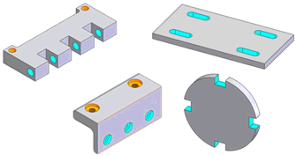

Discrete Feature Type Definition Supported Features Example
Pattern A group of DimXpert features having the same type (hole, slot, notch, etc.) and size parameters.
They are generally associated with common dimensions and tolerances. For example, applying a diameter dimension and geometric position tolerance to a pattern of holes.

Simple hole, counterbore, slot, and notch pattern features
