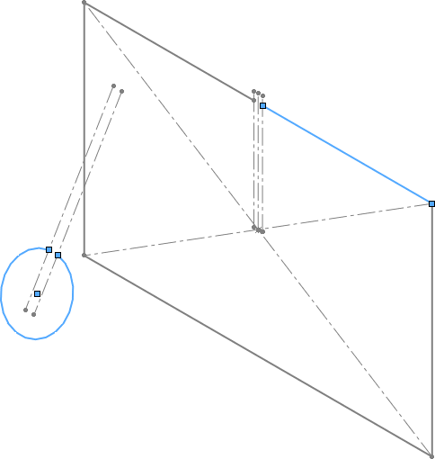

  3. In the graphics area, select the entities shown.

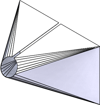

    Bent lofted bends form a realistic transition between the non-parallel profiles.
