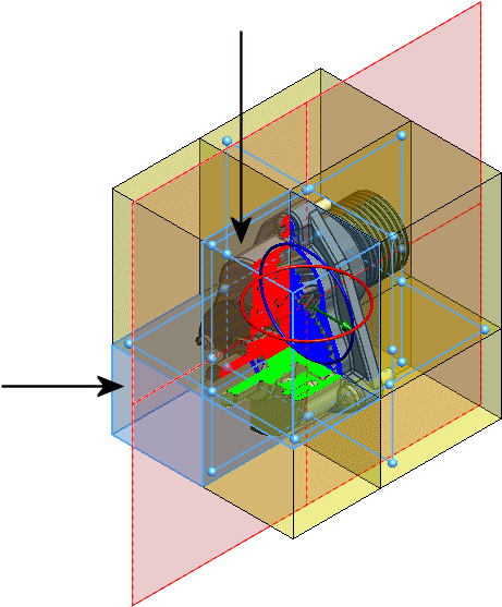

  7. Under Section Method, click in Intersection Zones.
    Shaded intersection zones display in the graphics area.
  8. In the graphics area, select the lower left and upper right intersection zones shown.
  9. Click .
