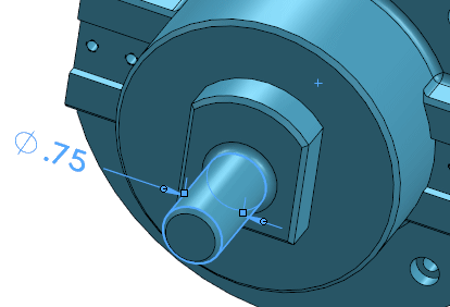

Reference Dimensions
You can use reference dimensions to create diameter and radius dimensions on cylinders and radii features such as holes and fillets.
Additionally, the silhouette edges of cylinders, radii, and conical features are supported when an Annotation View other than Notes Area or Undefined is active. These silhouette edges are also supported when the feature is orthographic to the view orientation.
