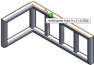

When you hover over a structural member feature in the graphics area, the tooltip uses the same naming convention:
This naming convention applies to weldments created in SOLIDWORKS 2016 and later.
