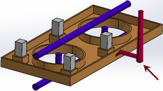

In addition to the cavity, mold, and insert domains, a new category for a runner domain is available. You can assign a runner domain to the solid CAD components which are part of a runner system.
You can assign a runner domain to a part you mesh with solid elements.
In the Solid-Mesh Manual PropertyManager, when you set the domain type, select Runner.
